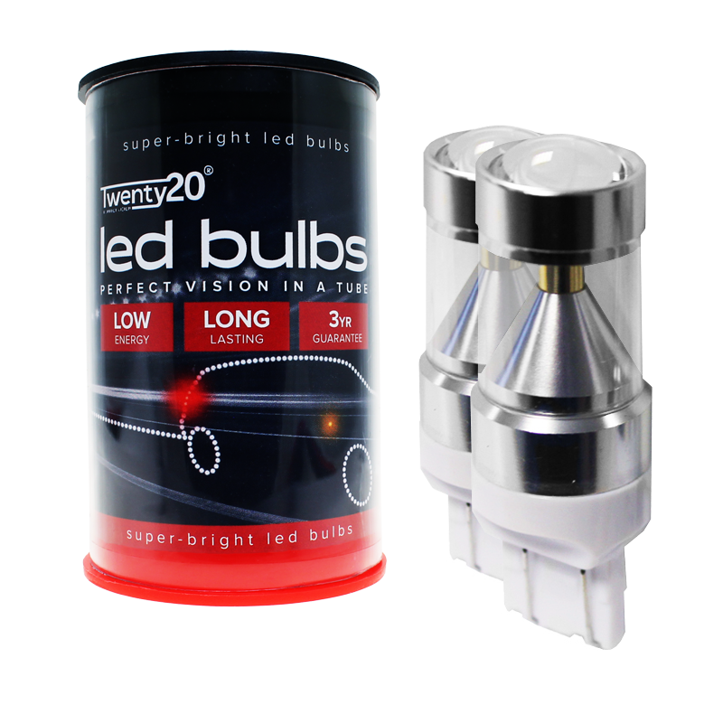

I've used Auto Bulbs Direct (ABD) in the past on many cars and trust their own branded products, the 20/20 range. So here's what on order for brake and indicators:
16W amber LED indicators aren't available in the 20/20 range, so going to fit the 21W version. From experiance, if they're deemed to be too bright to anyone behind me, I know of a way to reduce their intensity.
