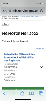

Not sure if this is in connection with what you are saying
That's probably it but the problem was/is more than a 'potential' it was an 'actual'.
Well it’s the only recall showing on there you can put in 2023 as the year of manufacture and nothing comes up in relation to any safety recalls just this one for any 2022 year
