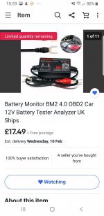

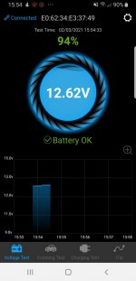

I've just fitted a bluetooth battery monitor which will notify me on app on my phone if my battery drops below 70% and again at 20% charge.

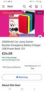

I have also bought a 12v car jump pack as a backup to get me started if it does happen again.
