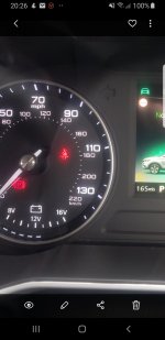

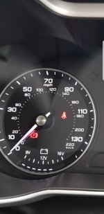

With regards to this 12v battery, I fully charged my car today and noticed that the 12v only went as high as 13/14v. Is that normal or should it get up to the max 16v marker?
That's about normal. You don't want it going up to the max, bad things can happen.
Happened on my bike, regulator went way higher than it should, the magic blue smoke escaped, and it got messy ?
It shows 5 blobs on 12v charged and 6 blobs close to 14v when car is charging the 12v when needed in ready mode.
Just to clarify, did you charge the 12 volt battery or are you referring to charging the HV traction battery @MrG ?.
When you boot up the car WITHOUT depressed the foot brake at the same time, you will only see the state of the 12 volt battery condition being displayed on the 12 volt battery gauge.
If you fully boot up the car to the READY condition, by pressing the foot brake at the same time as hitting the START button.
The car is now receiving a charge to the 12 volt battery via the large HV traction pack.
THEN you should see about 15 volts shown of the 12 volt battery gauge.
This is seen as two full white bars ABOVE the centre 12 volt mark ( six o'clock position ) on the gauge.
I'd need to have another look to be sure of what the actual figure is then. It was after charging the main battery from my granny charger, not the 12v.
