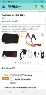

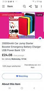

I've not tried jump pack yet. Bought one on ebay which I have put in car. Feedback was good and that you connect and leave it connected to battery first 120 seconds to boost battery.
Partner wanted one as a back up for her car and to power her phone when out and about. Got cheaper one to try from amazon.
