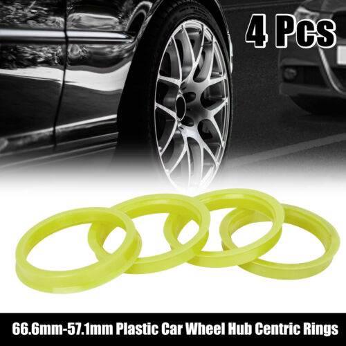

I missed out on the VW wheels, so I have done further research.
The ZSEV wheel is 7Jx17 ET41, centre bore 57.1mm, PCD 5x112 and 215/55R17 94V tyre.
On some HS models, the wheel is 7Jx17 ET41, centre bore 66.6mm, PCD 5x112 and 215/60R17 96H tyre. Nearly a perfect match except the centre bore and tyre size.
So source a 17" HS wheel, replace the tyre so circumference is the same and buy a set of 66.6mm to 57.1mm centre bore spacers. Then you can use the original MG wheel studs and only need to carry the spacers and spare wheel. Below is a link to plastic spacers.
