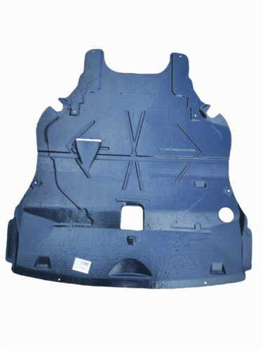

Miles confirms there seems to be a under-engine splash shield present under the ZS EV. Only problem here is a big aeration hole in the middle making it look as if there is no shield. I will look at sending more images. I have asked if this shield can be replaced with the ICE MG ZS shield which has no hole and I will update as and when that information is available. This is likely to be after the lock down I think.
So not sure what you folks think but this is a super aeration hole. Why does the electric engine need so much air?
My EV Buffins are advising not to spend money on this under-engine shield at present rather wait and try feeding back to MG en- block ie get all the over 1000 UK owners to individually write to MG complaining about this issue and may make some social and mainstream media noise. They are of the opinion a very cheap easy fix could be forth coming then.
Hmm... The lower front grilles on our cars, along with the periphery around the charging port in the main grille let in a lot of airflow through the radiator at speed. I very much suspect the large "hole" is to allow the exit of this air flow. The question that needs to be addressed before filling these holes up is where will the airflow go then?
Looking at the photo it would appear that the gear/reduction box is the main beneficiary of the aeration hole. My Hybrids have an oil to water heat exchanger to cool the gearbox although they are CVTs. Having said that, the hole does look a bit to large and still no wheel arch splash guard.
There won't be much dirt getting in through that hole, being in the centre, but a suitable wheel arch addition might be nice :)
I agree with all the comments made. I am told retro fitting a wheel arch splash guard and a finned aeration plate is the way forward. We should however proceed with these modifications only when we understand why these are absent in the first place.
Totally agree because there must be a reason for not fitting already developed parts!
