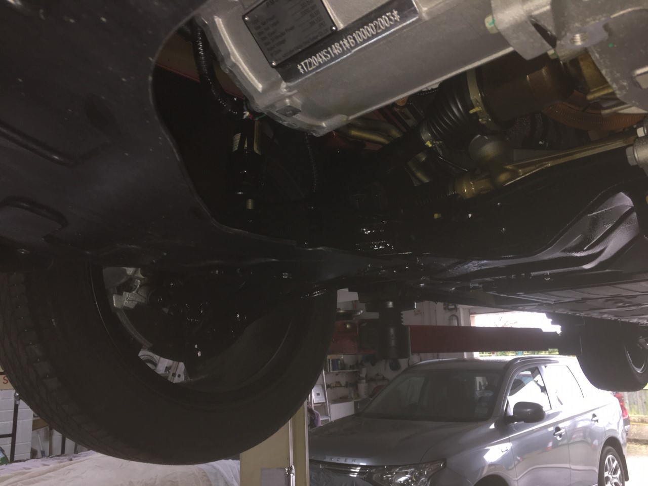

I checked every inch of the underside when I waxoyled it and It looked ok to me.
I was particularly impressed that every single fixing had marks on them indicating that not only had they been correctly tightened up, but also that this was then double checked.
I'm still very happy with my purchase. In 50 years of motoring I've owned over 150 cars, just 4 of them new one's. This is as good as any on them. The last one being a Kia Sportage.
I did check with my MG dealer before I Waxoyled it.....as I did 6 years before, with my Kia dealer. When the Kia had its final service before I sold it....the Kia technician took me into the workshop, to look underneath. They all said they had NEVER EVER, seen a 6 year old car with 60K miles that looks so good, I was dead chuffed :) .

View attachment 136View attachment 137View attachment 138View attachment 135
You look to have done a great job on the waxoyl. It's such a dirty job, I spend 3 times more time covering and removing polythene from the car, the lift, & the floor, than the actual job when I do this, lol!!

Very nice and stunning pictures @ Chrispydoc. Excellent pictures. Clean and oil/wax is excellent to keep things ticking over as new. The image above your pictures is the underside of the e-tron. Very well done by Audi. Please note that this Audi aeration hole has air ducts for the brakes. It is the opinion of my Buffins instead of having a finned aeration hole with ducts for the brakes like the Audi, MG have been a bit lazy and left a big hole with no fins to cover and protect from dirt or ducts for the brakes. However with the lower inside margins of the wheel arches being high in the ZS EV, the Air bellows about under the bonnet cooling both engine and brakes effectively but also bringing in more dirt than one may have expected in a 2020 car. To assess the lower margin of the wheel arches please look in to the engine bay with the bonnet open from above rather than looking from behind. My Buffins will continue to scout a solution but please ask around as well and post any comments and advice. We may not progress much on this issue much till after lockdown.
