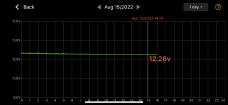

I have been monitoring our Mk2 and hoping to see the HV charge the 12v automagically at some point but nothing showing yet. Will have to leave the car for more than a couple of days to see what happens.

Andrew,
Just as a matter of interest why do you want to press the start button twice with your foot off the brake pedal?
Frank
It is the same as turning the key but not starting the car allows all the accessories to come on without running the engine
