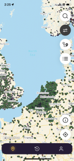

It is interesting scrolling around the apps. Here's London, but also everyone says the Netherlands massively into EVs - here you can really see it! That's assuming the Octopus app is up to date for other countries.

Okohll, but how does it look when you zoom in?
This is where my friend lives - pretty much where the words "Cardonald Park" appear. A couple of type 2 charge-points each with two connectors, within possible walking distance (but no fun in bad weather) but on the other side of the motorway (I think there is a pedestrian underpass), one of which is at a railway station. I believe the chargers at the hospital are restricted to staff, and possibly visitors. She used to work there, but she's now retired.
She says that if there were chargers in the car park at the big Asda store, where she does most of her shopping, she might be able to manage. But there aren't. It's not easy.
London seems to be much more sorted, from what people are saying.
