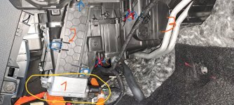

I attach an older image with a mark where you will find the cover that you must remove. Sorry because i have no more images.

OK, I'm going to try your fix. The noise is too annoying. I was able to remove the left side plastic to take a quick look and I think I've got it, knocking on the radiator I can hear exactly the noise. Next step I will remove the glove box, but then I didn't understand where did you put the foam/felt. In the picture you marked a spot, what is it?

Hi, when you remove the left panel, you will see a metal object with orange cables. That's is the heat unit. You must remove that unit removing knots at the bottom and a lateral cover that is in front you. Now, you can take out the heat unit and on it top, I put a lot of foam.
And the image, it is just to show the heat unit and the plastic. That mark it was for another topic.

Hi, i attach new image..
Red X--> if I remember well, these are not necessary to remove.
1--> first you have to remove all nut at botton of this piece. That piece are the heat unit and it is joined with a radiator. So you just have to unscrew and not try to remove it in this step.
2--> when all nuts from the piece 1 are removed, now you can take out this cover named 2. This is because the piece 1 holds a little part of the piece 1.
- Now, and if I remember well, you can remove the piece 1 and the radiator. You can take it sliding towards to you throw that hole where cover 2 was.
3- these tubes, are for the another one radiator. So that one just try too push down these tubes and now you will have access to the top of that radiator.
In my case, all rattles were coming from those radiators and plastic, so with foam at the top and bottom of both radiators, all sounds dissapear.
I hope that helps you, but if you need more help or anything isn't well explained, let me know and I will try to explain in other words. :)
