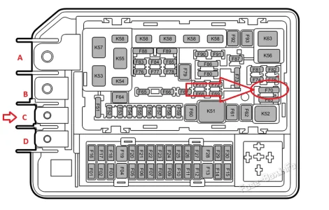

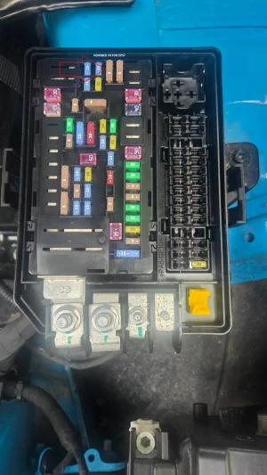

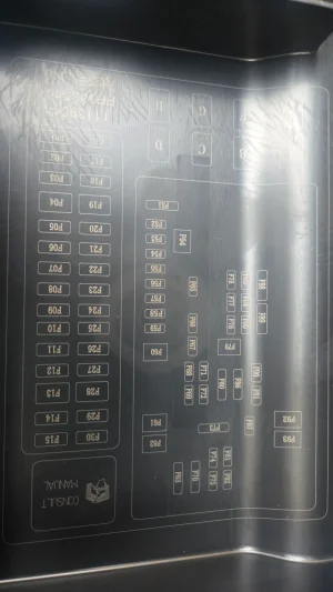

When you did your basic manoeuvrings into the driveway was the steering stiff ? I'm sure you have checked all the fuses , perhaps the earth path for the electric steering box was dislodged in its accident and/or the electrical connections points. Also assuming you have had the 12v battery either out or disconnected , a hard reset by reconnecting it sometimes can clear some of the faults.

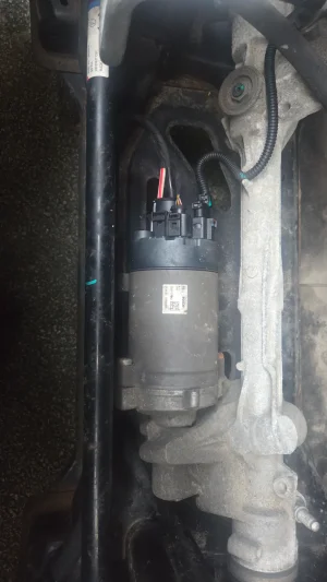

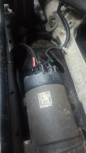

I took off the engine cover, and can see the steering motor, all seems fine there, with 3 large wires connected all on as they should be.

Noted, good news it wont be the radar then, as @OriginalBigAl says, check the earth to the power steering motor aswell as all the fuses under the dash and under the bonnet, it may not come up on an expensive diagnostic. On my MG4 a cheap £20 topdon will at least scan the MG4. Also have a look at the Google Drive on @haloweenhamster website, as all MG documentation is available - I managed up update the software (to R40) by reading the manual and searching around, within the hour.
