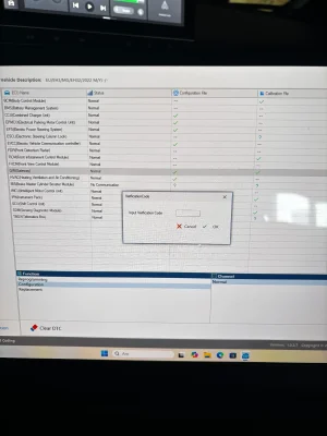

Where can I find this verification code?
You have the latest sips that requires you to log in to MG care & fill in a form to get the code. With the older version, this wasn't required.
So it means it is no longer possible to do the software updates without this code? Do you know which version of Sips does require this new method? I remember when installing SIPS last time with the version from the attached drive here I got the request for network interface as well, but ignored it...
Haven't checked Sips for a long time now.. so not sure if this applies for my version..
