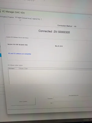

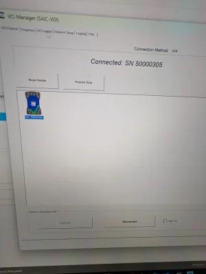

How do I update the vnci? Thankyou for your reply
With the VNCI manager. This tool should be also linked on the Drive in this thread.
This may be your Main issue why it fails ..
Edit:
Just to be clear.. I'm not talking about the Bosch VCI, it is the VNCI Manager which is shown in this post:
And here the Serial.of the VNCI + Firmware should be displayed. And there you should have the possibility to update.
I'm not sure if VCI (Bosch) Manager needs to be closed before opening the VNCI Tool.
And here the Serial.of the VNCI + Firmware should be displayed. And there youahould have the possibility to update.
I'm not sure if VCI (Bosch) Manager needs to be closed before opening the VNCI Tools.
Yes that's the one I have the yellow one
This is my vnci manager screens

Ah man do I feel stupid now haha. Thankyou buddy, I've read so much through here but my brain obviously didn't connect the dots
I have ipk back, thank goodness.
