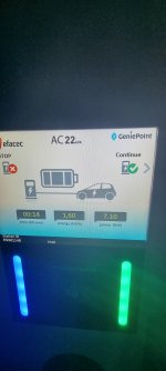

So I put it on a rapid AC charger.

Amdmad, I assume you have a 5 pin single phase input capability?
That would be 7.1 kw at input offering 1.6kwh in 14 minutes if I am reading the image correctly. That display is on the charger not the car. What difference was measured in the car?
It kept fluctuating from 2kw to 6 kw
Do you know what % was added during that period?

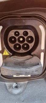

The car has this,is it 7Kw or 11Kw ??
11kw on 3 phase as pins L2&L3 are present for 2nd and 3rd phase. Needs a 3 phase cable as well.
EDIT: Also to get 7kw on single phase you need a 32 amp cable.
The type2 MG supply is a single phase 32amp so you won't get the full input from a 3phase on that btw
Have you got a 3 phase cable. Check L2 and L3 are present in cable. To get 11kw you need a 7 pin 3 phase cable.
Assuming you have a lr/ trophy with 61.7kw usable 1% is low in 14 minutes, should be nearer 1.6% but it depends on what % you started at. Above 80% slows down input....

Edit: 3 phase cables with 32A are often advertised as 22kW, but the MG4 will not do more than 11kW and that is only achieved on the LR.
Here's a link where you can select the cable type and see the price difference.
Also bear in mind an 11kw 3 phase (16amp) cable would only give 3.6kw on single phase (as it's likely muted to 16amp)
Yep MG are only supplying Single Phase Cables which is a shame, kept the 3 Phase cable from our EV6 and it works fine at 11kw on our Batch 2 MG4 Trophy
