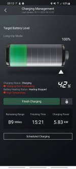

Is this about right on a 7Kw Tesco charger

Not far off. Delivers 7kw, allowing for losses mid 6's and then temp may have an effect as well. I would expect over 6 but chargers do vary so nothing to worry about unless its consistently low going forward

The figure shown is not the net of losses delivered to the battery, but the gross taken by the car figure. Assuming that you haven't got a dodgy lead it implies that the charge point is throttled and not offering the "full" 32A for some reason best known to Tesco/PodPoint. Instead you are getting only 25A. You really need to use a charge point that's not restricted and see if you can get the full 32A.
It would help if MG showed both current and voltage....

Bugeyed, do you know where it is measured. I would expect it to be measured by bms at delivery point hence convertor losses included but that assumption sounds wrong? I have always assumed 7kw input with losses at the convertor reducing DC power provided to the battery. I read this last year hence my assumption but everyday is a school day....Onboard chargers in EV's are typically only around 80-90% efficient.
The reading on my SR matched the reading on my charge point within 0.1 kW and my smart meter (allowing for my house's background usage) so I assumed that it was inverter in. But I have no proof that is the intention nor where the reading actually was.
I played with lowering the charge rate in the car and there was no indication of a loss in efficiency that you'd expect. Certainly efficiency in terms of charge gained was below the charge shown multiplied by time, but that would be expected whether measured as AC or DC.
