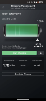

Hello (first time poster).
Thanks for any help with this. I don't want to start another new thread for range, so will piggyback off this one!
I received my new car last week but the range seems completely off.
My ismart app this morning shows a full charge of 170 miles for a Long Range 100% charge. This is only 60% of the 281 expected (okay, I know I wouldn't get 281 but this seems excessively low, no?)
Does this seem correct to everyone? The temperature is 2° outside, so not excessively cold.
Thanks
Mark
Thanks
Mark
Have you reset the Guess O Meter (GOM)?

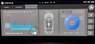

Turning off intelligent battery heating has seen my range improve massively. I mostly do short journeys and it doesn't seem to be helpful for those.
Intelligent battery heating seems to be catching a few people out, obviously you realise you are not going to get near that 280 mile range at this time of year, it will be a good bit lower

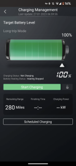

Turned off Intelligent Battery Heating, reset the GOM and as if by magic... 280 miles.
That would mean getting around 4.7 miles / kWh and using all of the battery capacity. It's lies I tell ye...all lies !!
Knock 100 off that for a more realistic number with some margin to get home.(y)

I’m not sure people understand that resetting the trip computer will temporarily show you max range but as soon as they start driving it will work out the real number. It’s a bit like resetting your ICE trip computer while coasting downhill and saying “ooh look my car does 99mpg”
