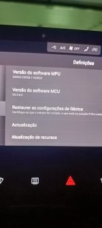

My 22, MG4 Standard Range, was updated today... has anyone noticed the On/Off Power button and the LPD On/Off option (in the shortcuts - dropdown menu)?
The display of the outside temperature is ok and has the new air conditioning menu.

Hello what the version of the système please?
The head of mechanics said it was the first MG4 SR that received this software version. Reported that he was satisfied with the problems resolved on this version.
