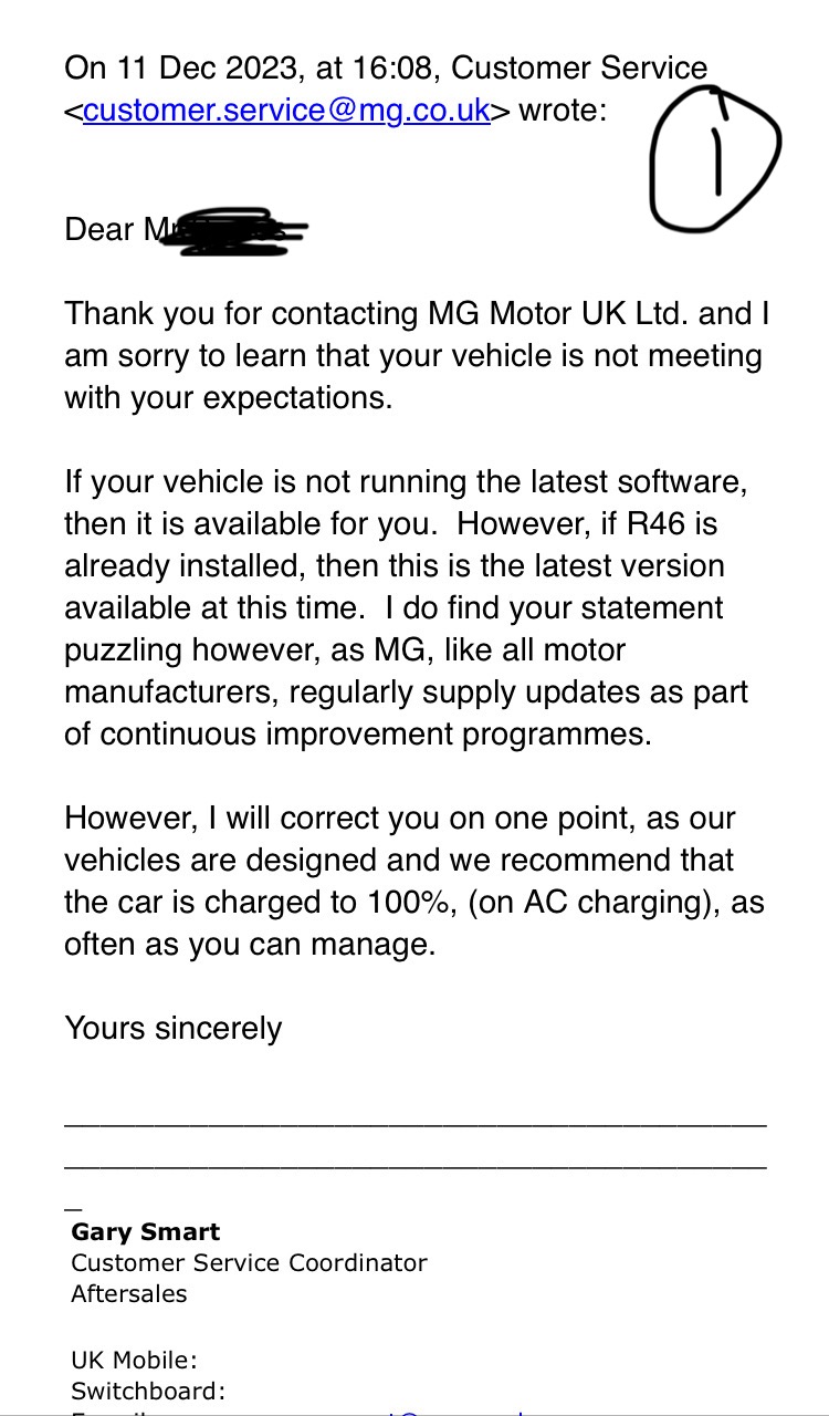

Not sure if this is the right thread, my trophy is on R33 and the car has been back to the dealers twice now ( undertray and a misting up brake lights, each time I complain about the Bluetooth issue and each time I’m told my car is on the latest recommended software from MG… so I emailed MG about the software issues, I also included the fact that my ‘charge to’ percentage kept switching back to 100%, I have attached the correspondence below….
So I shall take this email into my dealer on the next visit ( or service) , but I’d welcome comments on the charge to 100% in a trophy …. Have I got it wrong for home charging?

No you don't have it wrong, Gary does.
There are different battery chemistries, which he should have mentioned:
For AC:
LFP/SR: 100% charging always is recommended.
NMC/LR: 80% normally, 100% once a month or if you need the range.
I got this information from MG!
DC charging is whatever you like but the last 20% will be very slow. Not recommended to take it right up to 100% on DC unless you need that extra range - and very impolite if there is a queue for the charger!
In your second post Gary says the car charged to 100 percent as often as you can manage for the trophy. Totally opposite to everything I understood about 80 percent for the NMC battery.

DC charging to 100% is worse for the pack than AC charging to 100%.
Due to the fact that at DC there is no potential to balance the cell voltages.
You can balance separately and the LR should only need that once a month. As the charge level nears 100% the DC charge rate decreases to very low levels - comparable to AC.
It is the very high rates of charge lower down the battery capacity that are not as good for it as slow AC charging.
Thanks, I just remembered that the car actually tells you that 80% is the health mode !
I’ll revert back to Gary and suggest he may wish to join this forum where he is free to debate the correct way to charge a trophy. Unless we already have representation from MG
My understanding now (after several man hours spent researching the net on the topic) is that AC charging to 100% is fine even on a NMC batteries as long as it’s done via AC charging, and the car is used soon after. Not ideal generally, and even more so on NMC, but it’s ok.
As for how frequent this should be vs can be: it should be at least once a month to balance the pack, can be as often as you like because ultimately the pack will outlive the car and if you need the range you should well take advantage of it. The more often you do the more balanced the pack and more accurate the range reading, but yes degradation (state of health / internal resistance) also becomes more noticeable over the life of the pack, much more on NMC than LFP.
And even more importantly it is to understand whether you are cycling the battery from low to high voltage or only recharging partially within the middle of charge (say 50 to 75)

Thanks for that, my issue that I complained to MG was about the fact the battery charge percent level keeps resetting back to 100%. I only charge twice a week as my journeys are less than 50 miles in one go. Gary unfortunately opened up a can of worms. I absolutely love my Trophy, never had range anxiety. I think I’m turning into a grumpy old man who gets exasperated by all companies that can’t communicate properly or fob you off (like my dealer)… being retired I seem to write more complaint emails… first world problems … I love this forum and the fact that people aren’t rude and extremely helpful… I won’t wind Gary up too much as it’s not his fault, he’s just trying to make his way on this small blue planet where the dominant species is trying its best to make itself extinct… might go and watch some documentaries on the Fermi paradox… or have my afternoon nap ?
