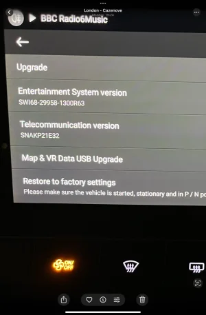

Just picked up our SE today. I asked before collecting it for confirmation that the Infotainment had the latest update. They assured me it had. However it's on R29 and I thought R38 was the latest for the SE? Is it worth making a fuss? Anyone know what the difference between the two versions is? Cheers

What’s the full version number? (It should start with SWI or DBI.)
I’m asking because MY24 and MY25 cars have different release numbers…

R38 & R63 have been class as overseas versions which include Australia for release
I would share a screenshot the release info but they now watermark the username which I'd rather not share at the moment
It's sw1132-29958-1100R29
That’s what I thought.
You have a MY24/MY25 car, and your software version is SWI132-29958-1100R29.
It is not the same as R38, which is SWI69-29958-1100R38.
The lower release number doesn’t mean this version is older; it just indicates that it’s the 29th release of SWI132…
Thank you. But I'm still not sure if I have the most up to date version!
(ie. Is the 29th release of sw1132 older or newer than the 38th release of sw169?)
