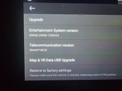

Infotainment update applies only for the Infotainment (MPU and MCU, although R63 doesn't have one of them anyway in the USB install, and R59's version is unchanged from R46 ... I think) - it does not update any other software in the car.
This is on my trophy

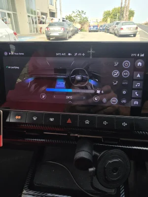

But get fixed what ? I prefer this to the new ac layout , and only had bluetooth problems lately which I assume are with an update on whatsapp.
