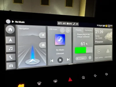

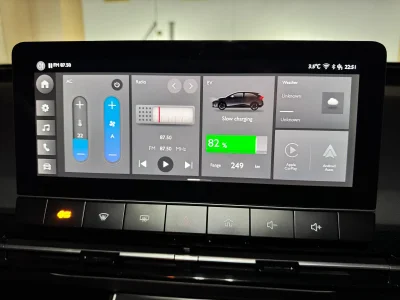

A few pics of some exotic releases on my SE/Standard MG4 here :)

Did you flash Luxury software too? Any issues with that combo?
I tried R59 and then R63 for a few months. It took a bit of tweaking to get everything working—maps and weather included. (You can look back on this thread around pages 210-230.)
But in the end, I reverted to the stock software, as I found out I was not using the integrated navigation that much.

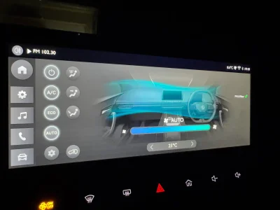

thats cool! What about fatures like reversing camera and safety stuff in the menus? Is that still present but not working (since there's no actual hardware present) or is software aware of this and doesn't show them.
Some advanced features were greyed out, and the reverse camera, of course, wasn’t displayed. Instead, I had the reverse warnings in one corner and a large image of the vehicle in place of the camera view. Sorry, I don’t have a better picture.
