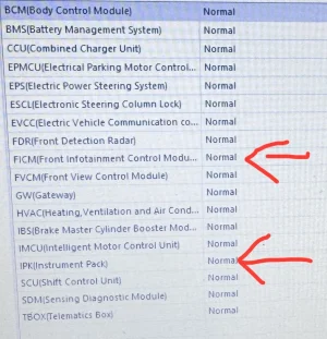

Do you recall when using this if it displayed the song being played in the drivers screen, like the Trophy model does?
No, the firmware controlling the driver’s display is the IPK (instrument pack), so updating the FICM (the infotainment system) will not change what is shown on the IPK.
