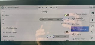

I finished installing the tweeters and front door speakers, and put quite a bit of sound deadening on the outside surface of the door panel, and a decent piece behind the speaker. I didn't end up taking the white plastic film off and putting more behind the door though. The new speakers seem to be a lot clearer and more bass, but almost too much bass. I'm getting a weird honking note which I cant seem to EQ out with the limited controls. It's not distorting/rattling...its like a frequency in between the first two sliders. Alan what are your EQ settings? Do the speakers settle in after awhile? Should I wait til I have the rear door speakers in to reassess?

Hi, check photos attached. I have the virtual sub off and loudness as they are not needed. You have to install a passive high crossover for the tweeters or they won’t work well and make sure the positive and negative terminals all match up.

Usually a polarity issue if odd frequencies are interfering or a short (or dodgy speaker).

Yes I think this was the issue, thanks a lot!
Glad it helped. The subwoofer settings muddle up the sound now the speakers can work across a lower frequency, they don’t need software enhancements to cover up the poor quality like the original ones do ?
