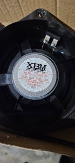

"25W RMS" - is that a typo or seriously factory speakers are just 25W RMS ? damn... that's cheap...
Here's a photo of the original speakers.

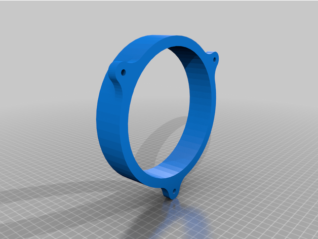

I don't like being destructive with original car parts so I 3D printed some spacers.

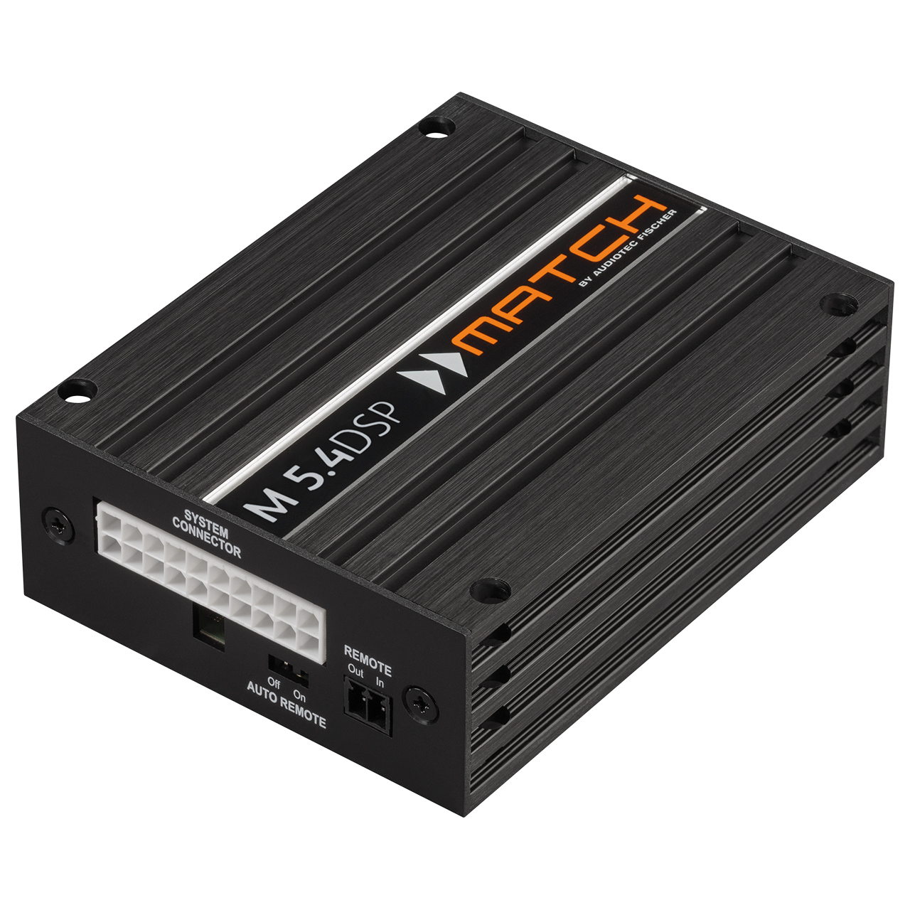

The other good thing about the Match amp/DSP, there is a harness available for the MG4 so you dont need to cut any cables. Other manufacturers might follow suit, I haven't looked since I had mine installed earlier this year
Can you link me to this DSP with mg4 compatible harness so i can check it out?

I see in your comment OEM speakers mounting depth is 63mm? these Orion says it's 2.96" which is 75mm... Can i use original spacers like the video owner or what can i get to space it properly?
I think you would need spacers that are 8mm less than the original ones. You could get the 3D printed ones I linked earlier printed smaller. Find someone local they should be able to resize it
How can i learn more about this DSP ? How is it installed, and is it an easy job for these mg4 with no risk?
Why DSPs are worthwhile
This is the DSP, best to get power directly from the battery and use an online fuse, rather than tap power from the fusebox of the car. It is small and can be installed near the factory headunit. I had mine professionally installed and tuned. Tuning is probably the part with the steepest learning curve.
This harness allows plug and play installation of the DSP without cutting wires
So far any issues with your car consumption and errors? Or it works as if nothing is added?
No errors or change in consumption. I even went on holiday for a month and came back and the battery was still on 80% as I left it, so there is no standby power draw either
Resize the 3d model? Or use as these models are made?
Resize the 3D model. Originally I suggested shortening by 8mm, but actually I think you might need to go the other way and add 8mm, seeing as your Orions need more depth than the original speakers. But then they might not allow the door trim to fit properly. Its hard to say...you might need to take the trim off and do a test fit.
