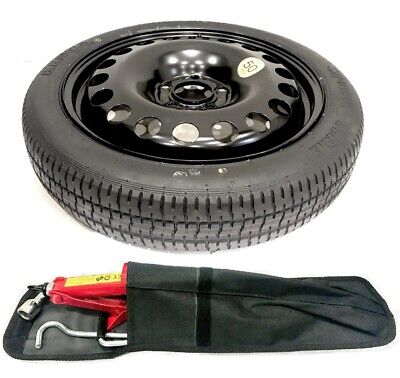

The price of the OEM spare wheel kit from MG has increased massively over the last twelve months.
When I purchased the OEM version early in 2020 - I paid £140.00 for the kit.
Now the same kit is £249.00 !.
That is massive, how do they justify that level of increase, supply and demand I guess ?.
You can still purchase an alternative more cost effected option ( £139.00 ) from eBay for anybody who may just want a basic set up of a wheel and brace for example ?.
Do you the eBay item number for that kit please
