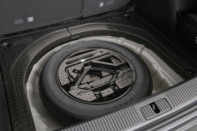

Anyone bought this kit on eBay?
I looked at that last night , and decided against it as no foam to stop Jack an brace from moving
I brought the genuine one
Genuine MG5 Spare Wheel Kit OE 10959444 | eBay

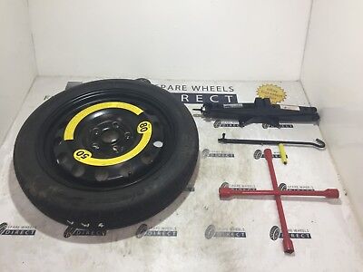

I bought a space saver wheel off eBay that was advertised as being for the MG5. I checked with him that it was suitable for the facelift trophy with 17” wheels and he confirmed that it was. The wheel looked good - 31/2Jx16 ET25,5 H2 seems to be the right fit despite it actually being a VW wheel - however it came with a 125/70R16 tyre.
I did some quick calculations and this is clearly the wrong size — the diameter is over 10% smaller than my normal wheels. I’d maybe use it to go slowly for a couple of miles to a tyre shop in extremis, but not if I was out in the Scottish Highlands 100 miles away from help! Here’s a comparison:
Obviously thinner is just fine and the rim size difference is irrelevant but the diameter just isn’t acceptable to me.
I got in touch with the seller and explained, and they were perfectly happy to either take it for a refund or to put on a new tyre. I popped back yesterday and they swapped it out for a 125/90R16, which is a much better match:
2.4% smaller is much more reasonable imho, and I believe it matches the OEM space saver spare — can anyone please confirm? I’ve bought a set of rounded bolts to go with the wheel (in a bag marked only for the spare wheel) and I’m now a lot more comfortable knowing that I have a decent spare to keep me going if necessary.
The seller was rosparewheels on eBay, based in Enfield, would definitely buy from them again.

Just thought I'd dredge up this thread in case anyone else was looking. Have recently bought a Mercedes A Class space saver wheel from eBay for £10, which fits in the spare wheel well in my 2021 LR pre facelift, and I can confirm that the jack/wheel brace/foam and even the towing eye from an MG6 work fine with an MG5, and the foam insert fits within the spare wheel, with the boot floor on its low level. Everything looks like it's a factory fit.
Full foam insert and kit was £30, and I bought some Mercedes wheel bolts for £5, so all in, it's cost me under £50.
My last car was a Merc C Class that came with a spare set of wheels when I bought it, the tyres were not new but still had a few miles on them.
I traded the car in for my MG5 PFL LR so I happened to have a spare set of wheels. Turns out the full size Merc wheel fits in the wheel well with the floor in the raised position. A jack from an old Landrover Freelander with a spare breaker bar and socket and I'm sorted.
I'm on the lookout for a space saver in my area so I can lower the boot floor but for now it will do.
