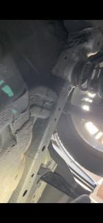

seen your post for pictures don’t know where rogerco was looking maybe in side the boot perhaps bug from underneath it doesn’t appear any different to me to be honest not easy to take pictures with out a ramp but done what I could here I did a video of it but these forum won’t let me upload it so here are a few screen shots from said video
I have been trying for ages but won’t allow me says file is to large so will try several post for you this being the first.

View attachment 14484View attachment 14485View attachment 14486
Thanks Les. Are those pictures of your original SR or a new one?. I was looking underneath particularly behind the plastic bumper on the new one and it seemed different to what I remembered under mine, but I didn't have them side by side, I didn't have a camera with me, and it was raining so I was reluctant to spend long lying on the wet gravel under it.
What I'd really like to see is where and how the towbar is attached on jpvdheijn's (or anyone else with a new one).
If the structure and holes are the same then towbar metalwork for the new one (without the ball removed so you couldn't tow) could be fitted to an older model as an "accessory" not a "modification" to fit a bike carrier - subject to checking with your insurance company if you are that way inclined (;)that's for you, Les !!!)
Hi rogerco I these pictures/video I tried to do are for the new uplifted 5 3/4 weeks old I think some where I have some video of the first model as well before I did an under sealing job on that one I will Send you a PM with details won’t up load here.

for facelift
I have done a few tow bars over the years with many modern ones requiring the removal of the impact bumper. However this is the 1st that I have seen that uses the bumper mounting and not requiring being fixed to the chassis underneath.
thear is a bar in the hole
fix to the chassis here
