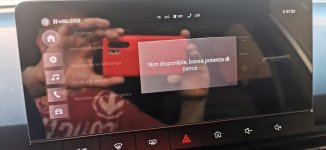

Hello everyone, I am a new owner from yesterday of mg4 standard new model, the car has the option to one pedale drive, but activating it I get this message (for non-Italian users function not available, low charging power) I called the dealer but as expected, at least in Italy, they do not know anything, they told me to charge the car to 100% (now it is 96%) it seems a strange thing ..... Thank you
As one pedal driving uses regenerative braking to achieve that función, if the car is at 100% soc or close to it then there can be no regenerative braking as the battery is full so cannot accept the charge from regereative braking. Therefore I imaging this is the reason you are getting this message, try it with your battery at a lower state of charge
Thank you very much for the reply, I had imagined such a thing but I wanted confirmation from the dealer but as expected, at least in Italy, you know more about the forum than them
Not just in Italy, UK too. I hope this fixes it for you. Thanks for asking the question, it helps inform everyone.

Good morning everyone, a strange thing has been happening to me for two days, even if the battery is at 76% it tells me that it is not possible to enable driving with one pedal, the function has always been activated even with a percentage of 80%, I don't know whether the drop in temperature over the past few days may have influenced the activation of this function, it has always worked properly but since the last charge I did on Wednesday the function is starting to do strange things, it has also happened to someone else ? Thank you
