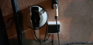

I got an electrician to install a timer to my pod point, it works a treat. £120 all in.
That sounds interesting. Do you have any more details please on how it’s installed, how the timer works, what parts are involved, how it works with podpoint etc? Thanks.
Upvote 0
He just cut the cable before the pod point box and fitted a timer with trio out switch, works great.

That’s great. Mines outside so it might not work for me. Is this just a one off or is it a company that I could contact? Thanks.
Upvote 0
mine is outside too, it's a waterproof box .
it's an electrician who just worked out what to do he is in leeds.
