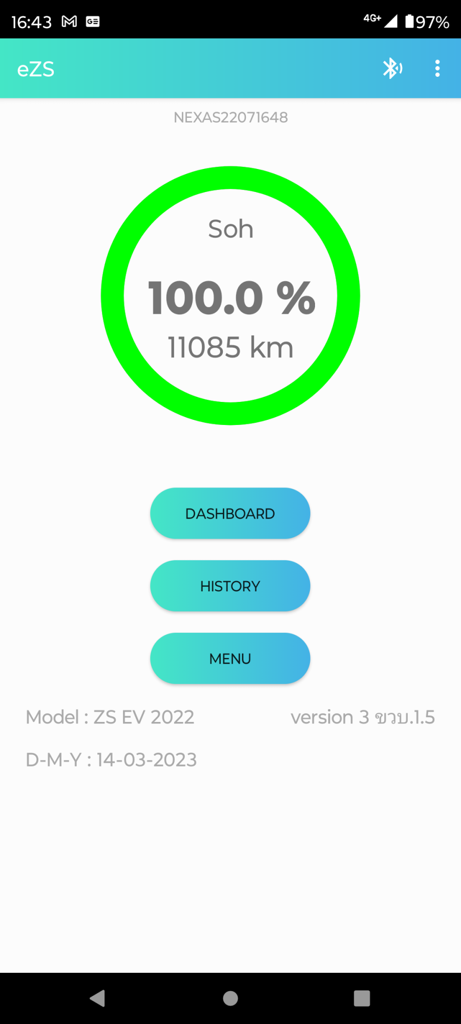

Hello all,
One year with my MG ZS EV Luxury.
SOH 100%
20.2 kkm (~12.5kmiles)
1 year old
<1% Rapid charging (3 Rapids done, all else is slow AC charging (between 2 et 4Kw @home)
About 10-15 charges to 100% (100% reached some hours before departure)
Mainly used from day to day office travel (80 to 100km per day).
Battery often between 50 - 80% charging (only 2 or 3 times below 20%).
My driving is not brutal but i remain very dynamic and don't count my kwh ! :)

Hello all,
SOH 100%
1 year old
[bla bla, zip zip zip]
Hello again,
First MG service last week !
So after 14 months (yes, i know, i was so laaate to do it :rolleyes:), my mileage was 23973 kms (seller tells me that warranty limit seems to be 24000km between services :eek:)
100% SOH again, printed by MG OBD tool.
Seems that MG ZS LR 2022 (NMC battery) has a great battery system and/or great hidden buffer capacity size.
Will give SOH at my next service.
Out-of-Context note for french owners : Great team at MG Vichy, 100.4€ for first service including a near 4 hours software update ! Electrical tests, but no fluid changed.
