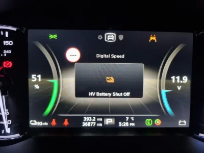

I got home and can't turn off the car just goes between ready green light with HV shut off and orange standby light. I have even tried 10 minutes with the 12v disconnected. Just waiting for the AA now.

So they did the washer fix in about 20 minutes.
