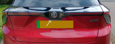

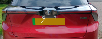

The camera is fitted above the number plate.
If that rear spoiler is easily removed I am hopeful that the backplate of the camera can lip behind where the MG logo is. My editing skills are not the best with images, but like this, lipped under, fastened and ending up with it looking something like the second image.

No its not as it contains the lights etc. Why not put the fixing bracket behind the number plate by removing the number plate first and then replacing it?
My reasoning was due to the problem others have had with the UK registrations plates and the cylinder of the camera being too close to and impeding the lettering, especially if you have the solar panel attachment. It simply looked tidy there in exactly the same location as the Trophy models own rear camera.

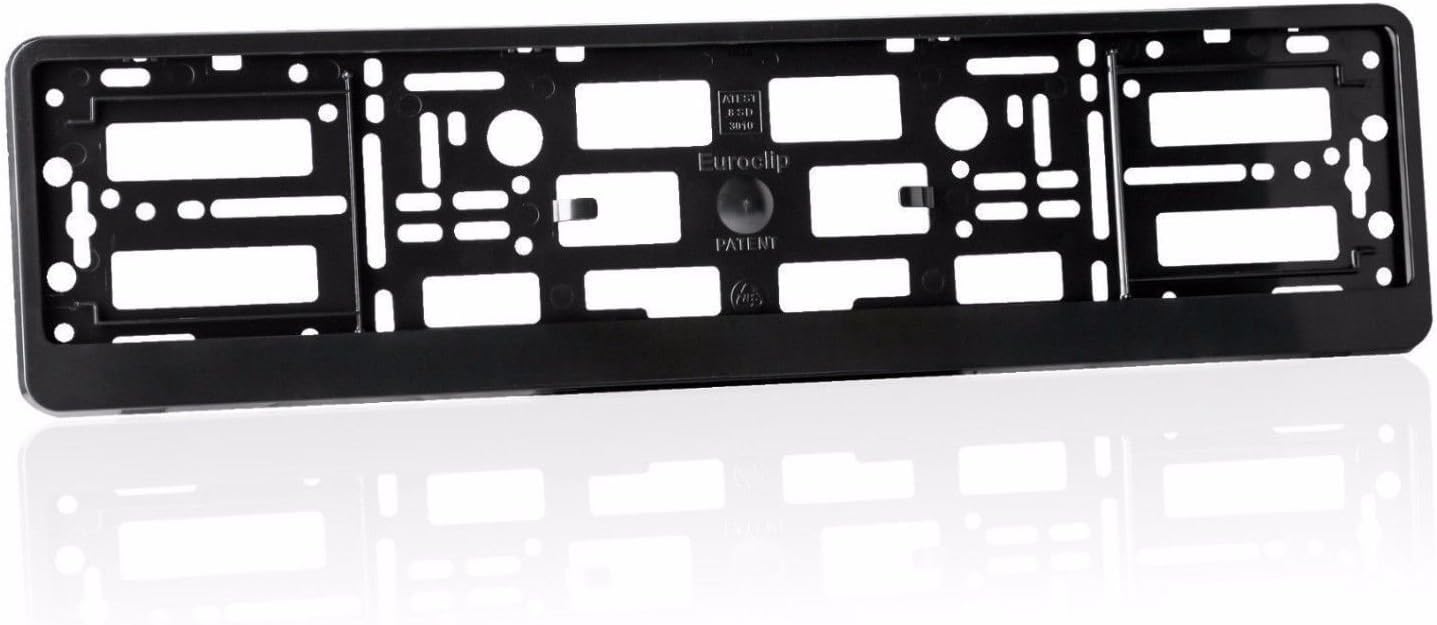

The other solution I thought is to buy a registration plate frame to give the much needed extra space to get around that issue.
View attachment 16820How the Luxury/Trophy looks wit a registrationplate holder. Should be fine to atatch a camera to/behind that holder.
Seems like a win/win all round, aesthetically and practically to fit the camera to a reg plate frame. Certainly what I will be doing when we receive ours.

So as promised, updating the thread here showing the wireless reverse camera affixed to a registration plate frame. I attached the frame to the factory fitted bolt holes instead of the cowboy drilled into the bodywork holes that the dealer did (a story for and from another thread!), this allows enough clearance to mount the camera at the top of the registration frame and give enough clearance to still access the boot release catch.
I used the standard euroclip registration plate frame with 3M VHB tape affixed to the reverse camera mount behind it. Note that you cannot fully open the hinge of the reg plate frame with that installed, but you can sufficiently open it enough to insert the reg plate and pull down the sprung holders.
Simple install and very pleased with outcome. Works out more cost effective to buy a pack of two reg frames...image of the front frame.....
