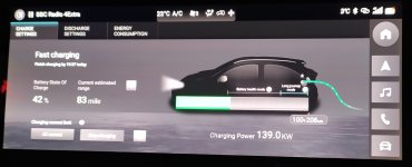

Here's mine pulling 139kW on a Tesla charger at 3C last winter. I'd been driving for a while at around 70mph so I guess the battery wasn't stone cold. No battery heating used. I just pulled up and plugged in.
You’d be surprised to know that the battery heating will kick in automatically while charging if the BMS thinks it’s required anyway: it will do so to protect the battery. It’s likely your battery was at a reasonable temperature to start with and it warmed up anyway because of the charging speed.
You’d be surprised to know that the battery heating will kick in automatically while charging if the BMS thinks it’s required anyway: it will do so to protect the battery. It’s likely your battery was at a reasonable temperature to start with and it warmed up anyway because if the charging speed
Well I didn't know that happened, but I'm not surprised to hear it as it sounds sensible!
