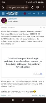

AMT mode will solve this problem in 30 seconds. Unfortunately my earlier post regarding AMT mode was removed from this forum for some reason better known to the Administrators !
? I don't think so. There is some glitch with the Facebook page, but I think that's at the Facebook end.
See for example this earlier post.
This says differently. Screenshot from a friends laptop. Certainly looks like it's not publicly visible. And even states it's removed or not visible ?. ?
