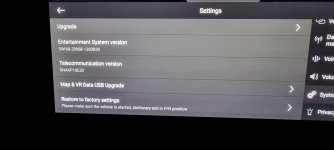

Just checked my XPower and it's R40, even though only registered 4 weeks ago. Is it possible to self install the update, or does it have to be done through a dealership please?
All software updates have to be done through an MG approved dealer.
If you have no problem with the installed software don't worry about always having the latest version as you might be exchanging one problem for another. I'm still on R24.
The SE cars have different software versions - believe the latest is R33.
However, this is just the infotainment- there are a ton of car modules that can be updated for various things, version numbers unavailable.

1st service on trophy LR yesterday and I’d reported rear camera not switching on, screen blank, sat nav freezing, phantom emergency braking , threw in the undertray warped again. I’ve got a list of fixes all saying software updated and to my surprise an undertray is being replaced under warranty. There’s a change of policy somewhere! The infotainment screen still shows 1300R30 and the air on screen is the same. Should I be seeing R41 if the software upgrades have been made?
I think R46 should be seen if your infotainment has been updated.

I just looked in my settings and I am on 1300R30 (and it's a 23 reg). I asked the dealer today and he said they don't upgrade routinely, only if they think a problem needs to be fixed and then MG advise them which upgrade to perform.
