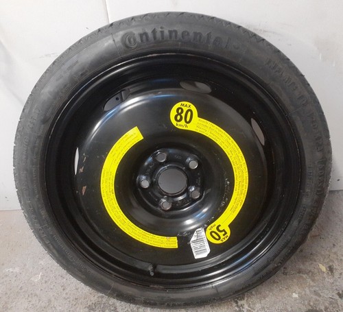

Just looked this up. The 16" golf wheel & tyre combo is far too small. There is an 18" VAG space saver option though, that will be almost exactly correct. Here's an example for sale on ebay at the moment:
Don't know the offset, but as it's a "skinny" and with the T-Roc that it fits having an offset of 45 (only 6mm different to the 4) it should be just fine with no risk of clearance issues.
Further, Offsets of anything between 30 and 75 on a 5" skinny wheel will sit within the profile area of the original MG4 wheel/tyre.

That's just the first example I pulled up, here's a bargain if you were close enough to pick it up! At least it shows what they sometimes can go for. :) Space Saver Spare Wheel 18" | eBay

The 18" VW is spot on, the 16" is nowhere near close. This is because, although they are indeed much higher profile, (70%) that's based on a very skinny tire width, so you don't gain any extra diameter from a smaller, skinny wheel with deeper tyre.

Parting thoughts... The 16" wheel is over 11% out on the speedo. Also, you really don't want to drive at all with that much difference on the driven rear axle, I know space is the issue for us here, but you might cause damage to the diff, I think the 18" at 2% difference is the only real option.
I have now purchased a space saver from ebay from a seat leon which is basically a vw golf its a 125/70/18. when the weather warms up a little I will find the best way to jack the car and see if it fits. If all goes well I am thinking of making a false floor in the boot with two hatches one side will be the spare wheel and jack and wheel brace and in the other side will be charge leads. I will let you know how I get on. Dave.
