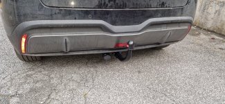

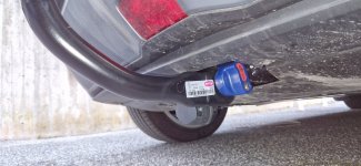

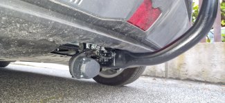

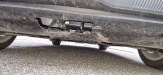

more details of my MG4 with tow bars

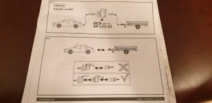

I note that MG says that the MG4 can tow up to 500kg, so I assume that there is a connector to the wiring loom for the trailer electrics. Does anyone know what towbars are available?
Witter offer a tow bar. The wiring loom is not yet available! The MG has LED lights which draw very little current. Most trailers have incandescent bulbs which draw more current, so an adaptor is required to provide 2 Amps at 12v for brake lights and a little less for side and indicator bulbs. I am told by local towing specialist that looms will become available when there is sufficient demand. MG will probably have one available but I haven't enquired.

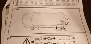

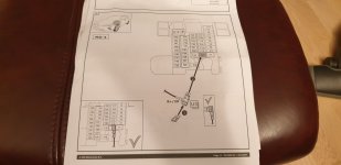

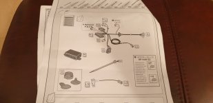

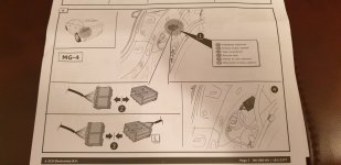

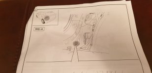

Got my new MG4 Luxury delivered wednesday 31.05.23 with a Witter towbar and a Witter car spesific wiring lom (canbus). It looks exactly like the one in post 112. The wiring lom (MG4/5 spesific) uses a exsisting hole in the left rear wheel arch (at least in the lhd) where the lom displaces the gromit/seal in the hole, at roughly the same place the canbus plug is located.

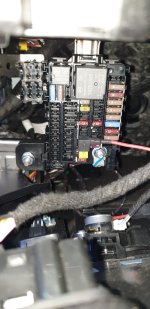

Power is tapped from the fusebox up front with a power trough fuse (same style as many use for their dashcams). Have not tested ut yet but it looks neat.
Oh, this is in Norway.
any pics?
No pics from the instalation (I was not there), but have some from the installation manual (wiring lom). Be warned that there are no waranty if not installed professionally and these pics does omit most of the important instructions.
My thoughts when taking these pics was to show the gist of it and a possible power take out on the lhd Luxury for lets say dash cams and such, not to publish the copyrighted manual. Rhd cars I guess have a different ruting of the cables and placement of the canbus and rubber gromit.
Edit: Added a picture of the power take out in the passenger compartment fusebox (90 degree power take out with 2 fuses).
Be aware that MY23 seem to have a different style canbus plug up on the rear wheel arch. So make sure your electric kit is for the the right model year.

No pics from the instalation (I was not there), but have some from the installation manual. Be warned that there are no waranty if not installed professionally and these pics does omit most of the important instructions.
