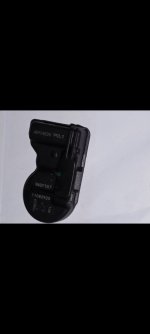

This sensor was in the Alu wheels, I think is original MG but don't work in the car

Circled is the serial number for one of the tpms sensors. Each sensor has a unique numbers so there are 4 numbers the car must know.
Those numbers are programmed into the car via obd. If you clone the sensors with each of those numbers and put them in the correct position on the car they should function.
