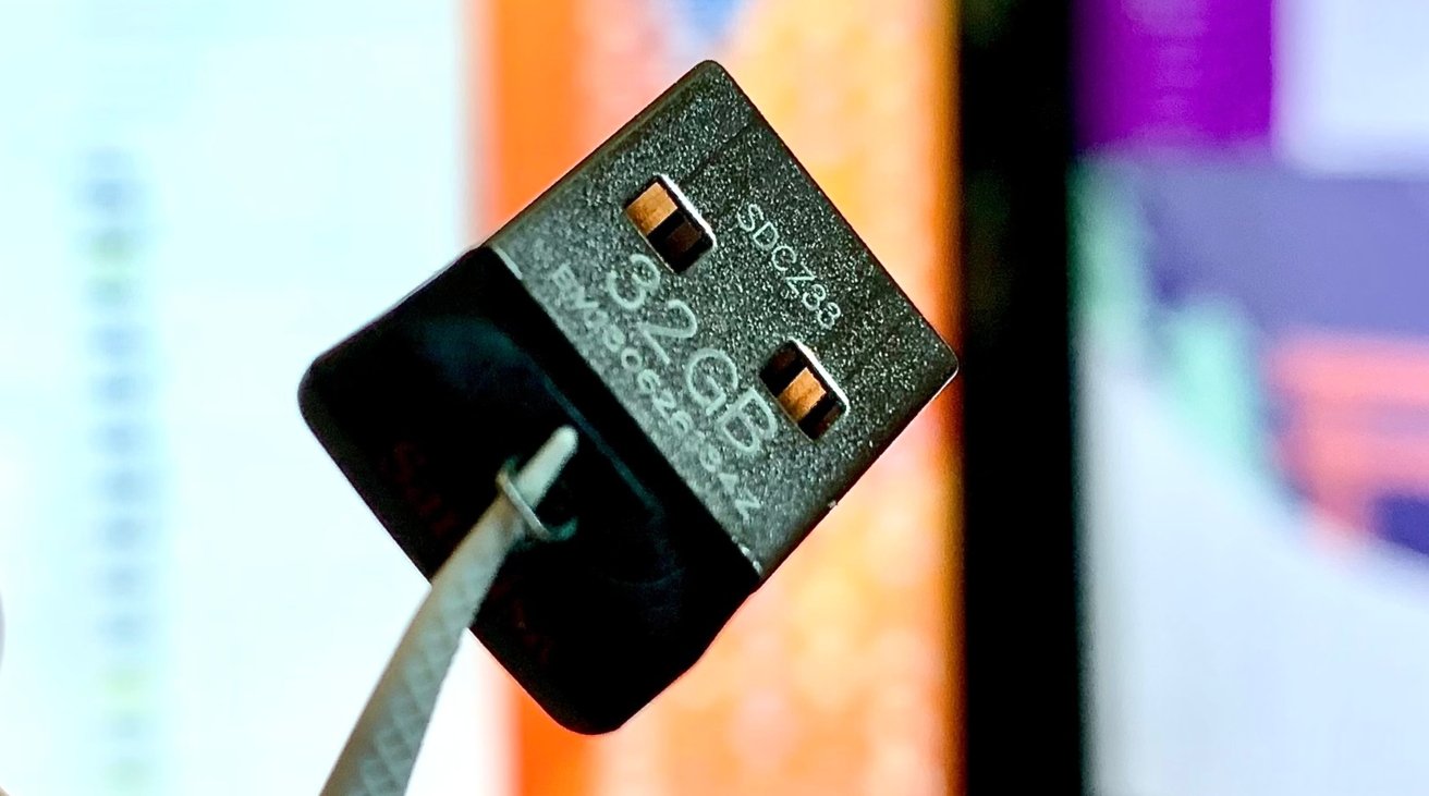

I concluded exactly the same - sadly, we don't have a Windows PC :confused:
Have never been an issue, see
Otherwise, just take a stick to an internet cafe or a hotel concierge & they will format for you.
