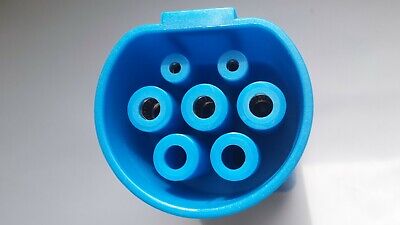

I got one of these. Nice and compact.

How do they justify that, for what is effectively a type 2 plug, some electronics and a three pin socket outlet ???.
Some profiteering going on THERE !.
There's not even any electronics inside it, just one single 420 ohm resistor to identify it as a V2L lead so the car can recognise what type of lead is plugged in.

Is this the same as 20.36£ 57% OFF|Male Power Supply Conversion Socket Charger Adapter For IEC 62196 EV RV Scooter Type 2 to Charging Socket Outlet| | - AliExpress
Yes. The internal resistor is across the wrong pins, and is the wrong resistance. I put 440 ohm in and works great. Tested with a 2kW heater.
Thanks - in anticipation, my 470 ohm resistors are on the way, too. So what pins are connected by the wrong resistor and how did you identify the right ones?
