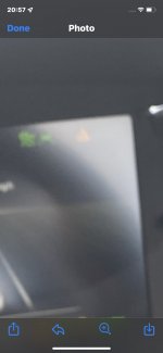

i put he car on cruise does anyone know what the the triangle with the exclamation on it in the top right means ? not a great pic my wife took it while i was driving

Use the buttons on the right side of the steering wheel to scroll left or right, one of the screens will tell you.
Sometimes seems to indicate there is another warning active. I'm pretty sure I saw it when there was a speed limit warning (which was not correct, there had previously been a temporary one but long since lifted).

Had a quick look at the handbook online for the MG5 LR and could be this as this appears to be the only warning light that’s a triangle and exclamation mark.

I think it's the conditional speed limit warning. It appears when the system (thinks it) has seen something under the last speed limit sign that might modify the limit it has detected, so the limit displayed on the dashboard should be regarded with caution.
Some good info thanks - it only come on with the cruise controle activated
Ok I got the fault info Ecall system fault Consult the handbook,
This is to do with the SOS button, I think its because I live in a rural location the car cant connect to a network
