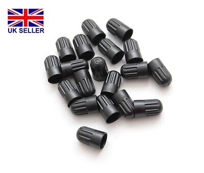

Getting them short valve caps off can take ages !.
What can make lift a little easier, is to fit the longer reach caps.
At least you can get your fingers around them.
