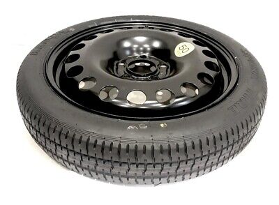

I had one delivered last week. Just as an FYI, it was a VW pattern wheel that was supplied. They're also sending me out a replacement because of an issue with the supplied tyre.

What size was the tyre and what was wrong with it
I'm in Australia and having trouble sourcing a spare wheel for my car. After searching various links including
they all seem to show no difference between the ZS ICE models and the EV. All seem to be 17x7 ET41 5x112
Can anyone enlighten me please?
I enquired about skinny spare from an MG dealer selling them on Ebay and first question he asked was EV or ICE. The hubs are different. The EV has same size and spacing as VW Golf / Audi and apparently MG5. From memory the stud spacing is 115 mm I believe.
