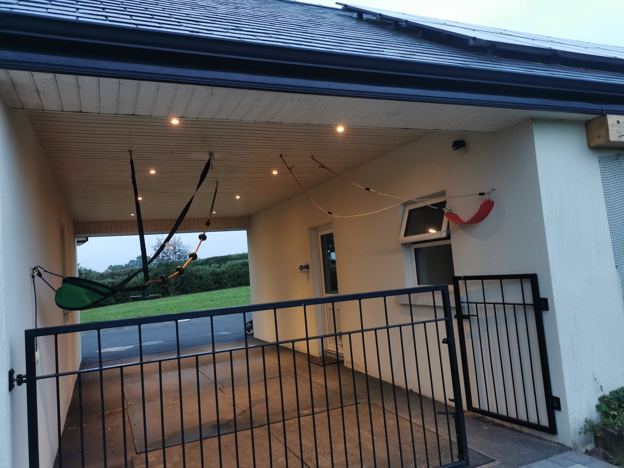

Im from Northern Ireland. Seems all right to me. Any comments??
Installation of one Hypervolt HOME 2.0 charger, to be located in the carport and fitted to the wall directly behind the garage consumer unit. No cables to be visible and to be installed throughout the fabric of the building.
Modifications to existing electrical installation, Proposed new charger to be supplied from the garage consumer unit. Existing RCD in the garage consumer unit to be replaced with a suitable A Type RCD.
Data cable to be installed from the charger to the generator change over switch for the CT (Current Transformer). Circuit breaker supplying the garage consumer unit to be upgraded to 40amps.
Total GBP 620.00. Which includes 350 grant and 50 grant for being a teacher.

Never heard anyone in the UK call it a carport before!
That's roughly the same price I have for install at the front of the house.

Looks all right to me. My quote for Hypervolt is £779, but that includes a longer cable run and more labour for getting the cable through roof space. This was quoted after a survey visit, which I was insistent on wanting.
I'm about £1200 before the £350 grant (and additional £250 Scottish grant) - this is for the 10m tethered Hypervolt, about a 15m combined power/data cable from new mini consumer unit and moving an existing switch that is in the way.
