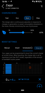

Remove the schedule in the car
Set the Zappi like the attached picture.
Waiting for surplus is not an error.
Make sure that the car is plugged in!
It'll sit there till 00:30 and start changing.
Good luck.

As someone else has said, what you’ve done at the moment is the correct process. Set the Zappi (or app) to Eco+ and the car waits for Surplus from the sun. You can then set a schedule on the Zappi (or app), and it will remain at ‘waiting for surplus’ until your scheduled time arrives, at which point it will charge.
Just be sure not to set a schedule in the car as well, as this will cause all sorts of conflicts.

Thanks, but I'm getting lost (again). Does this mean that the overnight schedule I have set won't happen? Or will it? And you are saying that a schedule wouldn't work for a daytime setting a full battery? I am trying to understand!!
The settings in the screen shot earlier will charge both
00:30 - 04:30 at full power
AND
in daylight hours if you have enough surplus solar power that you would otherwise be giving away
00:30 - 04:30
AND
Thank you. I think I do now understand - and am reassured that I should wake up to a charged car 🙂
No warranties are implied or expressed - but those settings have been good for our MG4 for over a year now and 19,000 miles.
Also don't be confused by the slider with the leaf symbol that I have set at 60% in my picture - it's NOT charge the car to 60%. Leave this at 60 or 70% but don't worry about it for the time being.

I now appreciate that, for example, that on a sunny, summer day, if I set the Zappi for a night time charge, it would use any surplus solar that day while the sun was shining, before my schedule kicked in. In my ignorance, the ‘irrelevant’ message at this time of year just floored me.
Excellent well done another happy Zappi 😉
I'd expect 26 or 27 kw in a four hour charge but of course if there is unused solar generation before or after the night time charge and the car has capacity to take it you'll be topping up with ☀️
Just be aware your Zappi will need a surplus of 1.4kw to start changing from solar - this is not a Zappi or MG limitation. So if you think the sun's out but the cars not charging, check the level of export on the app.
Set that slider to 60 or 70%.
