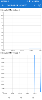

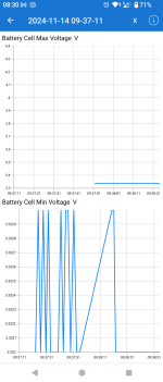

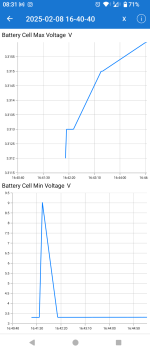

I realised there is cell voltage in my car scanner app but no idea what it all means , good or bad ... Also, can't remember if this was at 100% charge or not ...
