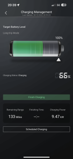

To follow up, I can confirm definitively that the MG5 facelift can charge at 11kW — here it is on a 22kW charger using a 3 phase cable.
Thanks, I wasn’t sure if it’s worth investing in a type 2 22kw charging cable.
I did, because you get the best of both worlds. Will work at 7kW on a 7kW charger and 11kW on both 11kW and 22kW chargers. Especially if goi g abroad this can matter — imagine using a French 11kW charge point with a single phase cable, you’d only get 3.5kW (single phase 16A)!

I have the MG5 Facelift. I can confirm it comes with a 11 KW (max) AC charger but you will need a 3 phase cable to get this speed.
I know this as I had a single phase cable which capped out at 7. Now I have a 3 phase and get ~11KW
