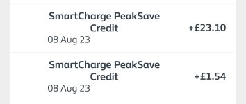

So very slightly cheaper than Octopus Go and British Gas are currently giving cash back with their charger installed. My cash back for August below.
