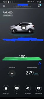

So I charged our Mk2 MG ZS LR Trophy to 100% for the first time since we bought it middle of last year. Used A/C to get it up to 100% from about 30%. I was hoping to balance the cells so charged it to 100. Took a few hours but we got to 100. I noticed something weird on the app. Is that meant to show me the battery health or is it just bad design of battery display in the app? I've marked it where I think it might be the battery health bar. Is that the same with everyone as well?

Wife took ours for its first long drive up north, stopped twice at rapid chargers each way, came back and I charged to 80% on our fast charger. The GOM now says 230 miles at 80% charge (before was about 190). Did notice that battery was being heated at the rapid chargers, could this be the difference? driving was on motorway at about 60-65.
Nope. That bar underneath tracks my main bar exactly. So much so that I thought it was just a 3D edge design element of the percentage bar….
